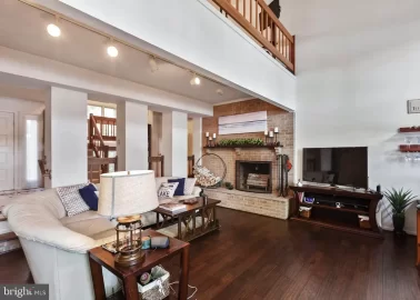

Hi All -
My wife and I recently purchased a lake house that has a large fireplace in which I'd like to put a wood-burning insert. The home is 3,400 sq feet built in 1987. It's an open floor plan with the majority of the living taking place on the first floor - think 80's contemporary modern...sunken living rooms, open spaces, loft space of the two-story living room, etc. The home also has a centrally located fireplace which I would like to make the primary heat source given how open the space is.
The details are as follows:
- Height at front of firebox = 28.5"
- Width at front of firebox = 36"
- Height at back of firebox bottom = 28.5"
- Width at back of firebox top = 29"
- Depth at firebox bottom = 23"
- Depth at firebox top = 18.5"
- Chimney height = ~30' and straight
- Insulation = decent R15 throughout
- Windows = mid-90s double-paned Anderson casements
