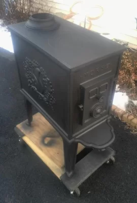

I am a new owner of a green Lange 6203. This stove looks to be in pretty good shape. I don't see any signs of over-firing. All the burn plates and top baffle are straight and true. The enamel is near perfect; no areas of discoloration and no crazing or cracks. There are a couple of chips on the door (from banging into something, not firing) which I plan to fix with Jotul 'Ocean Green' touch up paint available at Rocky Mountain Stove. (Note: I've put the green Lange 6203 right next to my green Jotul 507 and the greens are nearly identical. I have a sneaking suspicion that back in the day, Lange and Jotul used the same enamel vendor. Note Part Deux: Rocky Mtn sells 2 Jotul green touch up paints: 'Ocean Green' and 'Green Majolica'. I believe the Ocean Green is the 'old skool' green you see often on the 602 and 118, and the Green Majolica is that brighter, livelier green being used on the current glass front door Jotuls. I'm going to take my chances with Ocean Green matching up with the Lange 6203.)
I have not yet fired the stove, nor have I done a 'smoke bomb test', but I can tell by looking closely at the seams that a little stove cement/mortar should be applied. I plan on getting some Rutland stove cement in the tube, cutting the tip close to the top so as to produce a very fine bead of cement that I will apply to both the inside and outside of the seams (making sure to wipe off any excess so as not ruin that nice enamel !!) I'm not being lazy here by not taking the whole stove apart; cleaning out the seams; applying the cement; and then re-bolting. It's just that the stove is sitting so fine that I don't want to mess anything up and/or pull some bonehead move like chipping the enamel bc I can't get it back right... Comments?

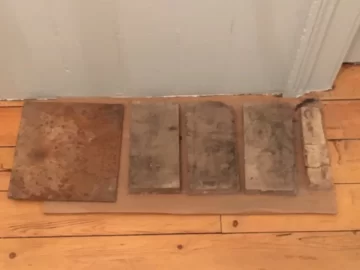

The only other curious thing to report is that sitting on top of the bottom cast iron plate, I found 3 (well, 3 1/2) standard size (9x4x1.25) fire bricks. See Photos. I know many of these vintage Scandinavian cast iron stoves have a sacrificial bottom burn plate that sits on top of the bottom cast iron plate, but I'm not sure is there is such a part on the 6203 as I can't find an 'exploded' parts diagram on Woodman's or anywhere else. Anyone have any feedback here? Additionally, it was recommended that a bed of sand be put in the bottom of many of these Scandinavian stoves. I thought the fire bricks might serve this same purpose. Is there anything to worry about in keeping these bricks versus putting a bed of sand? I sort of think keeping the fire bricks is a good idea...comments?
