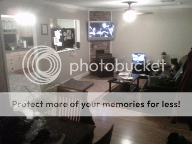

Hello all. New to the forum. I have been a wood stove guy since my childhood and still have one at our hunting camp, but my wife is pre go with our first so I decided to go pellet in the house we just moved into to supplement the oil hell. I went with the ps 35 because I like that it looks like a traditional wood stove, and I'm a cop so price was definitely an issue (I don't make much denaro). I also like that it is made in America with all quad parts and is not a big box store unit and is serviceable by dealers.
I did the install myself as I am pretty handy and have installed many wood stoves. Before I ask my questions, I know that y'all like specifics about the install so here goes...
It is a very small 1000 sq ft ranch (24x60?), no basement, just a 3 ft crawl space. There was an existing masonry chimney in the living room which I assume used to have a wood stove installed. When we bought it was just a hole in the brick face and a very small amount of creosote near the opening.
I built a tile hearth pad, ran the electric and thermostat wires, and installed the stove. Venting is all pellet pro. It starts with a T, then a 12 inch pipe, then a 90, which then enters the chimney and is converted to a 4" ss chimney liner all the way to the top of the chimney, terminated with all ss parts up top to keep the critters out. I covered the hole around the liner adapter in the brick with the front half of a wall thimble and sealed it to the wall and pipe to prevent air leakage. It's actually a pretty clean and pro looking install for a pellet rookie, if I may say so haha.
Any way, the house is as stated very small and a ranch. If looking from the top, I will briefly explain layout from right to left. 2 car garage with small addition behind it. Next to garage is the living room and kitchen, divided by a wall with a large eating island cut out. The stove is in the corner of the living room against the kitchen wall on the back and garage wall on the side, blowing right at our couch area. Next to the living room/kitchen is a bathroom and then 2 bedrooms at the other end of the house side by side.

First, I am definitely worried about overheating the living room and having the bedrooms be freezing. I got a panasonic whisper quiet duct fan for free brand new from a friend that is rated for 150 cfm. I wanted to install it in the ceiling of the LR and then split it into the two bedroom ceilings which would be very easy to do from an install standpoint but I keep reading on here that people think this process is a waste of time and fruitless. I also got insulated ducting from him and he is an hvac guy and said it should work but as I said I keep reading mixed opinions on here. I know there is a risk of negative pressure but I will keep both br doors open to negate that. I always read people saying to put fans on the floor and push the cold air from the bedrooms to the stove, but I don't want my pregnant wife to have to deal with fans and wires all over the floor. I read somewhere that the air would only loose 3 degrees in transfer and I figure that taking warm air from the ceiling of the heated room and dropping it from the ceiling of non heated rooms would follow the "rules of convection" (if there even is such a thing) and should theoretically work well to even out the temperatures in our little house. I know this topic has been beat to death but I always read opposite opinions, some say it works great, some say it is idiotic. I really want to do it since I like installing stuff like this and I got all the parts for free but not if it will be a waste of time.

Great stove you got there... Moving the air is key. But before you go punching holes in the walls, check your local code... Many areas differ and there is a large grey area there. A pellet stove is a space heater. In order to heat your Entire Space, this warm air must move.. I am a fan of the corner doorway fans. I own several. 2 EntreeAirs and a Minuteman.. I like the Minuteman a little more.. It has 2 speeds and also comes with 2 mounting brackets.. So not only can it be used for 2 different rooms at different times of the day.. It can also be reversed, so it can blow into the room, or suck air out of. Whichever works best...

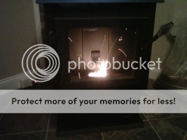

I still feel like its not spitting out enough pellets and I have the feed all the way open now. Wth? Is there a potentiometer on the control box that can increase the auger speed?

As far as pellets, the feed plate should be all the way up and then the stove set to high. The flame should be 4-6" above the pot. This all depends on a few factors. One being pellet quality, the other being your venting. You are on a inside wall.. Did you go up through the roof (inside wall=yes) ?? What is the vent set-up? And what size pipe did you use? 3" or 4"??

Thanks for all the replys guys. Much appreciated. The feed gate has been open all the way and the stove works fine on high but barely is above the pot on med and low. I talked to the dealer and he suggested checking to make sure the thermocouple was touching the ceramic all the way in. When I checked that, I noticed that it was an eighth of an inch or so away. I pushed it back in but then noticed that the wire almost pulls it back away due to how it is flexed. Is it normal on quad stoves to have no real mechanical fastening of the thermocouple to keep it firmly pressed against the end of the ceramic cap? I find that weird. Everytime I check after burning the stove I notice that it's back out a bit. The dealer said this could be causing the computer to not feed enough fuel.
The dealer Also mentioned that I could turn up the feed rate potentiometer on the computer by on click which would apparently increase the feed rate by 10% on all heat levels. I already did so but it's been so hot lately that I havnt had a chance to turn the stove on to see if it worked.
Also I've noticed that nobody has really chimed in on the air distribution question. I am really curious to see if this will work. It seems like it would but I don't want to waste time and install it if it will have no effect. As I said previously I got all the ductfan and parts for free so the only cost would be my labor. The few times I have had the stove running the two far away bedrooms were much colder than the main living room which I think will just be worse in the winter. I am determined to find a way to heat the whole house with the stove alone. It has to be possible. Any input or experience with moving heated ceiling air with duct fan and ducts would be greatly appreciated.
