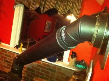

Can you post a picture? I don't think it will matter as long as you have double wall anywhere you need it. Although I'm not totally sure I understand what you mean by "airspace holes" I think you are talking about the area between the single and double wall.
Exactly toploader, it's the space between the two, but now that heated air will be exiting the pipe rather than traveling through it. You can see in the pic the single wall piece is attached to the thimble.

Well I don't think that's a problem but I wonder if you need that elbow[close to the wall] to be double wall?
Had the same observation. Normally one does not mix single and double wall in a connector run. The single wall elbow looks closer than 18" to the wall. Not sure about the combustible hanging on the wall adjacent to the elbow. If so this must be changed to a double wall elbow.
I was thinking the same thing so I called and left a message with PF to order an adjustable double wall. Ill confirm with them in the morning. I don't mind doing the break ins with it like that, but I don't really want want to run 24/7.
Or maybe go with the double wall horizontal run out from the wall you had before and then the elbow if that will get the 18" Begreen mentions.
That's a good idea, ill probably do that if I can't get a double wall one. I'd like to limit the horizontal if I can, to keep the good draft it has.
Begreen, I agree. I'd rather not use the single wall at all. Oh, the thing on the wall is good, high ignition temp.
