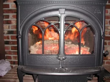

This point bears repeating. With my Jotul F600cb it is very easy to lay a piece of wood in the stove that blocks the air port and it sure slows down start up.
It's also something to watch for when reloading. Sometimes I will place small blocks of wood on each side of the port and then put a piece on top of these smaller pieces..... the air from the port blows under this larger piece and often results in getting a nice secondary combustion burn going again quickly.
From what I'm hearing in this thread the culprit is likely wet wood but even if your wood is not optimal it pays to watch that airport.
