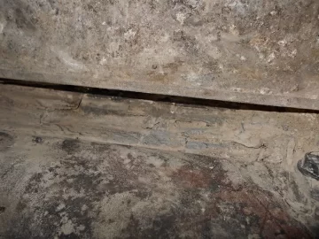

1.Jotul Oslo, this will be my third season burning. I have posted some pics. As I was cleaning it out it seemed like this "silicone" on the right side (facing the stove, not the door) is coming off. Is that something I need to get fixed before burning season?

What I am seeing is just slag cement from assembly. It's normal for chunks of excess to fall out over time. Not sure what you are saying about your stove pipe though, can you post a pic of that?
