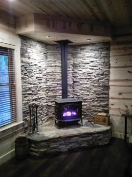

Here's a photo of this morning's fire as I type this. Thank you to everyone on this forum that helped me choose this stove and learn how to operate it.

Sounds like you like it! That's quite a hearth. It's a nice setting for the stove. Thanks for posting.
Great review! Stunning install, can’t wait to
