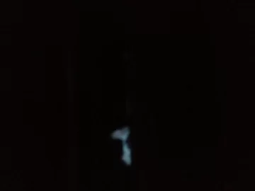

Pilot lit...turned to on position.
switch to ON position...no click..however small flicker of flame at front of burner...tap with handle , no change
Toggle switch between off / on same results. no change in flame when turning from lo to high

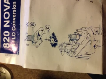

Is it possible to have not installed the regulator tower improperly? No directions in booklet to convert back to NG just a photo for going Propane.

The small cone shown I figure 'C'
I used the white plastic one included there was also a copper colored one as well in which I didn't use

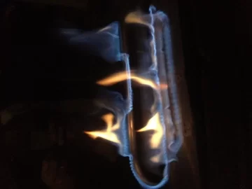

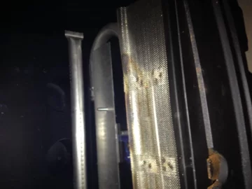

Using my old needle meter...Showing just over 3 Ohms
we now have a flame!
Removed and reapplied the regulator
Will once again check for leaks and make adjustments

you shouldn't be dealing with the spring and cap, not field serviceable parts.
you need a fully encapsulated regulator any time you do a change.
