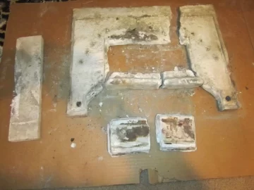

Also for anyone interested, I'm posting a couple of pictures of the disasembled inside of my Jotul Firelight model 12 along with pictures of the parts I need to replace or repair.
I believe the burned out inner backing was from when the knob on the ash door slipped and caused a hot fire.
The parts I'm hoping to repair are the face of the catalyst chamber. Has anyone ever tried that type of repair?

My chamber was damaged in a different way. The corners / ends were eaten off by a squirrel, so it was more than just replacing the front panel. If you're sure you can make a satisfactory repair for $120, it might be worth a try. I was more in the mentality of, "if I'm taking this whole thing apart, I just want it like new when I put it all back together."
The most important question is, if the parts you were shown are so badly damaged, are you sure there's not anything else damaged? Spending $1000 to get a like-new Jotul Firelight 12 is a fantastic deal, but spending $1000 and then finding out there's some other major problem would really suck!
Some would tell you to go to a newer non-cat stove, but others are actively switching back to cat stoves. It's really just a matter of personal preference, and both have their advantages.
The stove appears to be rode hard and far beyond where I would have done a rebuild. My concern would be other damage done by waiting too long.
