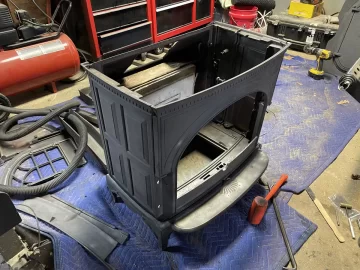

Sides front and back are on now. I think from the factory they put the front on first, then the sides, then drop the back straight down from above into the cement grooves. It was a pain to get on and set as it’s still freezing here, and the stove cement/mortar thickened quickly with the cold. I used waay too much cement, but at least I’m sure it filled every nook for a good seal.
I left all the bolts loose until it’s was good and centered and I was sure everything was aligned properly, then slowly torqued everything down. Plenty of cement squished out everywhere that I reclaimed for the jug.

Nice work, my old jotul 3 somehow hade the sides a bit out of alignment and would let some whisps of smoke out at start up. (when i used old school smoky start fire starting). Glad to see you took great care to keep everything straight for a tight fit for the Top.
Thanks! Yeah this thing takes a ton of cement. I’m sure if I did it again I could use half what I’m using now, but as it stands I’m using a large tub of Rutland and a caulk tube of the furnace cement too.
