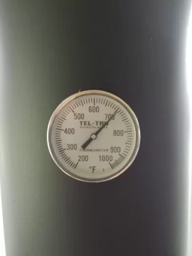

Here is a pic of my flue pipe, the tee snout is about 8-9 inches long. If I put a thermometer there am I going to get a reading that really means anything or is it too close to the stove? Once the liner gets past the block off plate it is insulated all the way to the top. Also this is in the center of my home not an outside wall

Is the tee class A insulated chimney?
The tee is not insulated, it’s single wall stainless pipe. It’s part of the 6” pro liner.
How well can you see the tee when adjusting the stove? Perhaps place a surface therm at the top of the tee right before the transition.

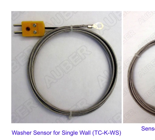

Can’t see it very good because there’s only about 1” of clearance from the stove pipe to the top of the fireplace opening, I was thinking of using an auberins thermometer and a surface mount thermocouple like this
[Hearth.com] Jotul F500 burn
Excellent, I was going to suggest Auber.

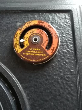

As for measuring the stove temperature, I place a Rutland magnetic thermometer on one of the corners as the Jotul people state in the manual.

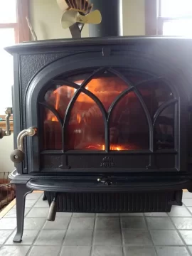

White oak and a some basswood, dry wood.
15min from first lite in a cold stove.
Good secondaries.
Air supplies closed down, ready to run.
With dry wood, flue temps rose fast, and could have been shut down sooner. 15min later, only secondaries are visible, stove top 350.
