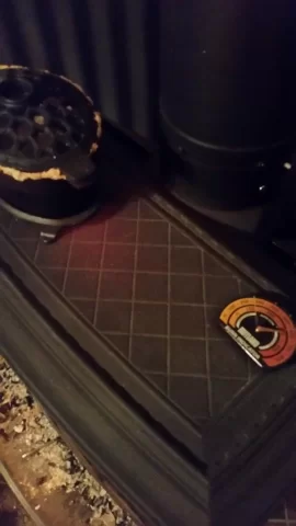

I have a f400 with completely straight 16' chimney (6" double wall). The stove is finicky to say the least and it burns hot! It seems that the hotter the stove gets, the hotter it wants to continue getting. I will say I live on a mountain overlooking a large field and it gets super windy. I had the company come check the stove for leaks and they confirmed that is air tight. They did say that my draft is too strong, nearly 1.5x jotul's recommended limit. But did not offer any advice on how to remedy.

I've never had the stove burn over 650 degrees (thermometer top right of stove top), but at 600 degrees the center of the stove top starts becoming a dull red, the secondaries are burning like torches, and the air wash plate will glow.

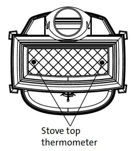

This is where Jotul recommends placing the thermometer. It could be possible that your thermometer is reading low. Do you have another to verify its accuracy?

Thanks for the reply. Much appreciated. I think I am going to look into a high wind chimney cap. I have my thermometers placed in those two spots and both read the same. What frightens me is that the thermometers will show 600 degrees, and the center of the stove top is starting to turn red. I don't understand it.
Have you tried a different thermometer? I’m very skeptical of that thermometer being accurate.
Yes, me too. that dull red area has to be about 900F+.
