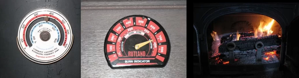

These photos were taken a few days ago about 45 minutes after the first fill of the day. There was a substantial bed of coals left from the night before, so I just put on two medium size pieces of cherry about 16" long (ya, breaking the rule of three splits at a time). When I checked the flue temp it was 375º F, stove top was 700º (both confirmed within a few degrees by my IR at the time). The last photo shows the inside of the stove right after I opened the doors, and the mighty conflagration that was responsible for all this heat.

Yes, you need some space for a good burn. What I have found with these smaller stoves is that you can load them up pretty much with as much wood as you can fit inside because you are not loading that big of a charge of fuel to begin with. It only takes about 1/2 hour before the load burns down and starts to settle giving you space for the more efficient, prolonged burn. It doesn't make the stove put out any more heat as you have to back off the primary air to keep the stove within a good temperature range.
