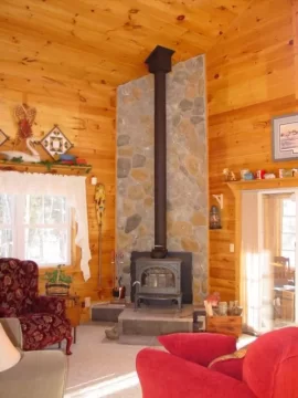

just installed this castine and it works like a champ

Beautiful installation Pinetop. Looks like your stove has found a real nice home.
That is beautiful. Enjoy.
thanks...originally there was a gas fireplace inset in the rock face rather than tear it out i disabled it and then tore out ashelf hearth and extended it for the stove i've got about 20 ft of chimney including 7 ft. on the outside and it drafts very well we had to go a bit off center to achieve a straight shot in order miss a rafter didn't want any elbows in the install ..which was done by a certified installer.
Looks great!
What brand inside stovepipe did you use? Double or single wall?
the dealer i bought the stove from uses excel pipe thats double wall to allow for 8" clearances and naturally he said excel is certainly far superior to any competing brand and being the sucker i am i took it hook line...and sinker
That install looks like it should be in a jotul catalog ... Looks great
