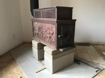

Any modifications could cause the stove to operate in an unsafe manner or you could have insurance issues if you had a claim but I’ve heard of people cutting the legs down or just removing them and setting the stove on cement blocks or pavers.
Send D.Hermit a PM he’d know.
My jotul 118 clone with no legs is on cement blocks , but it's to raise it up higher.

It should work if the bolt pattern still matches and the new stove is installed on a proper fireplace hearth. However, if the stove is sold, the original legs should be reinstalled as there is no tested hearth insulation value for the shorter legs on the new model. They should address this soon. Hearth installation is a popular application for this stove.
