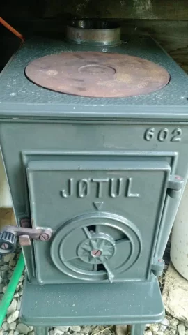

I just purchased a sweet little Jotul 602 in excellent condition.- except that the bottom burn plate is missing. Searching (broken link removed) comes up empty.
Anyone know where I can find a replacement?
Or how about another solution such as fire brick?
Thanks!

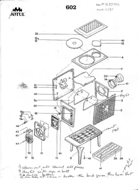

I wish that was the part I am looking for, but it's not. There is a protective burn plate that sits on top of the one pictured. Rock Mountain Stoves doesn't have it either.

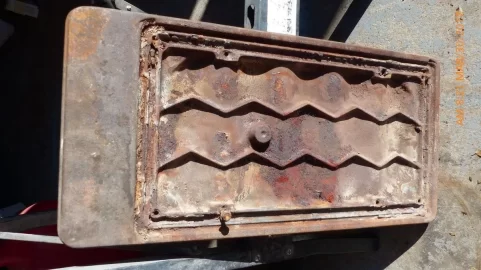

Or is this it?

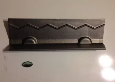

or this ebay part?

Sorry, you're out of luck then. I couldn't even find an actual picture of that part. Just line the bottom with firebricks, or buy a piece of steel plate cut to size from a metal shop. That's a beautiful green color. You can make it into a good stove.
Greg
p.s.
You might consider trying this parts seller in the UK...
http://www.jotulgroupspares.co.uk/jotul/shopsc/jotul-f602-bp/exploded/31.htm

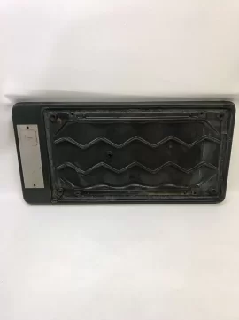

Would highly suggest that if you can't get the bottom liner from your local Jotul dealer, I'd look at another stove. You should not modify any stove to just use it, it could come back to bite you. Good luck.
I'd get a used 602 with a defect for cheap and scavenge it for parts. In lieu of that I would probably use some firebrick with an inch of sand on top, but only if I had a well insulated hearth underneath the stove.
For example - This stove needs a new back, it is shot. If the interior burn plates are also warped or cracked then it is basically scrap value, but the odds are the part you need will be just fine. Offer them $50 if it has what you need.

The Jotul 602 part #35 base plate is non existent on the 2nd hand market. Wondering if the 2 1/2 pieces for the 602 Fwould fit...hmm

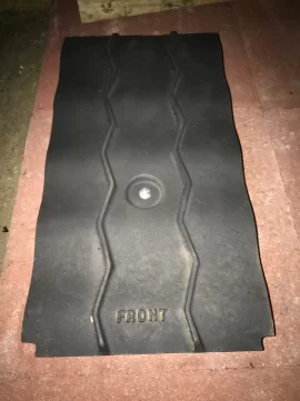

Thanks!
[Hearth.com] Jotul 602 - Is it Ok to burn without a lower burn plate?
Woodsman parts in NH plus had your piece if you still need it.
