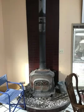

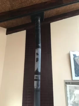

Hi, thank you for the information I'll attach some pictures if that helps. I also measured the hearth and it is 55X40 I would guess the single wall stove pipe but purely a guess. No we do not have a ceiling fan and it would be almost impossible to mount (I've looked into it). Yes it would do a better job of distributing the heat but with the open floor plan and the other rooms being about 3 feet up from the room where the fireplace is. We actually get a fairly good distribution. It just takes a bit of time ;-)

Not sure but that looks like ventilated double-wall stove pipe that got too hot at one point. Has there been a chimney fire in this system?

CHIMNEY FIRE ! Now you are scaring me ;-) . Not to my knowledge, but I made the thing glow years ago and did not know that was a dangerous and bad situation. So clearly I misused it, could it be that I had one and did not even know it? Philly

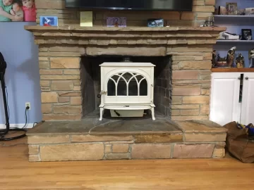

I’m new here but just wanted to add my insight. We installed an F400 one month ago. Reasons for choosing it over the others was it’s looks and simplicity and size. We hearth mounted inside the 42x29 fireplace. My father-in-law has one that I have run and liked it. Ash removal is easy.
I started looking at the F400, decided I wanted white/cream finish, and didn’t want to mess with QuardraFire burn controls. I kept looking for a couple more weeks and didn’t find anything I liked more. The down side, as mentioned, is the small fire box. I would not choose this stove to heat a small house without backup heat. It would do 1000 sq ft fine, but it’s not an all night burning stove. If I leave a good ash layer I can restart from coals after 6-8 hours.
I hope this info from someone who just made this purchase is helpful. I’m happy to answer any other questions. Jotul 400 cast iron vs. competitors
Yes that may have done it. The paint can lose it's bond it the stove pipe gets too hot.
