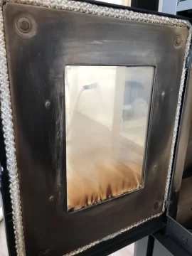

1- Since it’s pretty hot outside the stove really run often on first setting (low burn phase) and it is getting my stove much more dirty than during the cold winter. There is brown soot on the windows and wall after only 2 days. I do not always run it on auto/off because I don’t like the idea of wearing out my igniters. It depends of the outside temperature and if there is sun or not. Could this be the issue?

Regarding pellet quality I’m on your side. I went with what my dealer recommended me when buying the stove but they are aweful. I completely fill up my ashbox every week and while it was better during cold winter day my glass get really dirty. Next winter I will try more brand to find a better one.

I also did a little mid week cleaning like I usually do. I joined photo of before and after cleaning. The stove was cleaned 4 day ago. There is some back creosote on the sidewall but it’s not as bad as it was. Maybe it’s working better now
It has also been working flawlessly last night (high/low) and today (auto/off). It’s still on heat setting 4.
