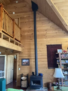

Here’s the whole shebang! All advice and suggestions appreciated!

Can you post a picture of the whole stove pipe?
just posted the picture….. now I’m wondering when begreen says “we have an adjustable stove pipe”, do you mean it is something I can buy from you all, or that they are available, say, from the dealer who installed my stove?
The bottom length looks new. They should have put in an adjustable (telescoping) section of pipe at the bottom.

Yes, the bottom section and collar are new. When the stove was installed, that section had not arrived yet. They came back 2 weeks later to attach the new section….I don’t know the brand. Was waiting to call the dealer till I heard back from some of you on this. There was a sticky label attached to the back of the pipe, but I removed it before the first burn. I can find out if it is Selkirk DSP - and what do I do with that information then?
It looks like the bottom section is 48". If so, it could get replaced with an adjustable length that can go from 38" to 68". This probably should be done by the dealer given the long length of stove pipe there. Or you can just accept it the way it is installed. It's not dangerous. The bolts can hold the load.
Thanks for the reassurance that the bolts can hold the load! That means I can use it while I wait for the repair. After going 14 yrs with one that never worked correctly and always waiting for that dealer to come fix something, I’d rather start out with everything the best way possible! I’ve spent enough on this that I would rather spend a little more (hopefully only a little) and get it done now. Whew! Thanks to everyone that chimed in, I SO appreciate the knowledge and experience that gets shared on here. Now back to reading thru previous threads - yehawwwww …. lots more to learn!
