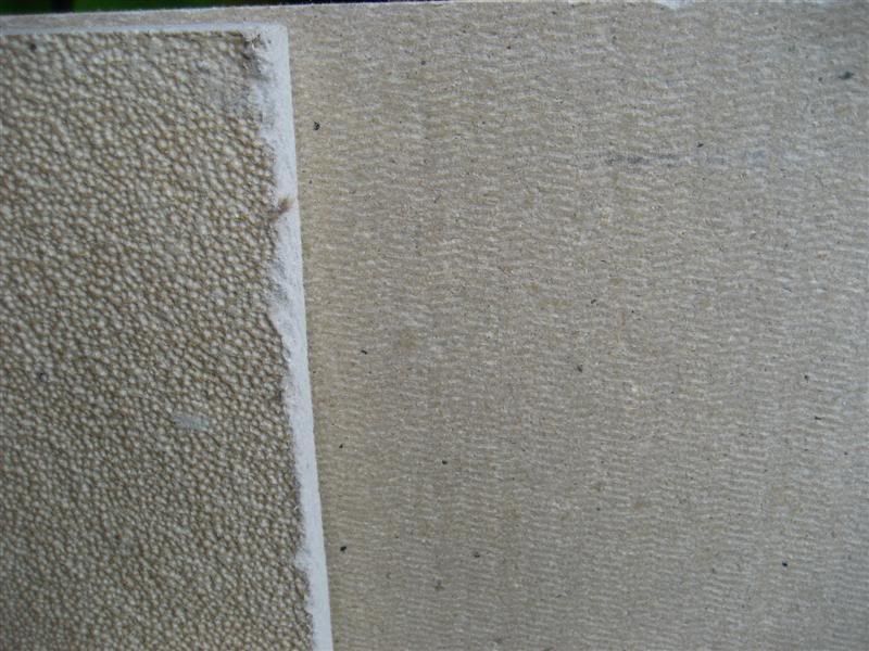

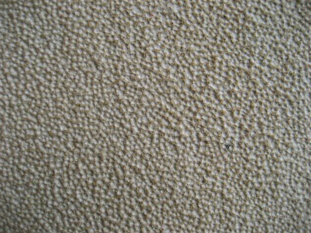

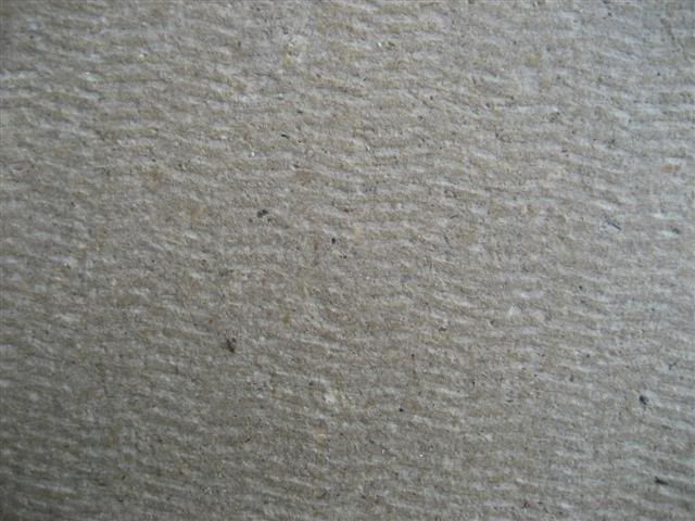

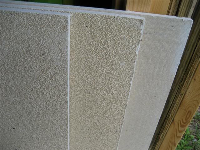

Ok, anybody want to ID this micor for me. This is what I picked up today. Does it look like micor that you've worked with???
Thanks! Ed

The reason I was wanting to get a positive ID on the "micore" is that I bought this from a place over the phone. In conversation with them at their place of business and then again on the phone, the conversation was about "micore". They are closed on Saturday so they left it under their back shed for me. The trick is that I had to drive 125 miles one way for it. The invoice that they left for me was hand written and stated "microboard". I'll be calling them today to verify what I have here.
Thanks,
Ed
