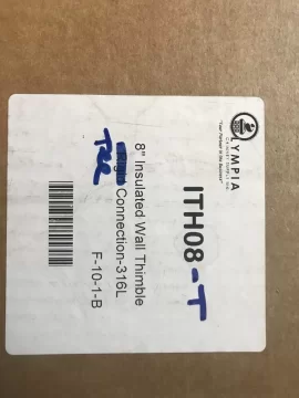

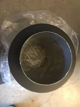

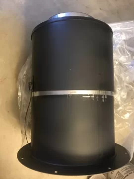

I ordered the rigid 8 inch and received a modified sticker. I am guessing I received the correct one. Just don’t have any pictures of what the tee snout version looks like. So I am guessing a tee snout would have some pieces with it that look like the last picture since it doesn’t appear you can bend a liner 90 degrees. What I received is in the 2nd pic. Thanks.

Maybe this is the Tee connection insulated thimble.
It is. What's in the box? You can always just cut off the tee snout portion. Any time we order them for stock we order tee snout ones. Then cut half of them
Looks like I received the rigid or they cut it off like you described. Is it possible to get parts to make this rigid version work with a liner when the clay tiles fail?

I don’t see the spec for how far the finished end of the thimble should extend into the living space. I think I read to set it 3 inches past the wall? Then adapt your stove pipe to new center section of the thimble. Thanks.
