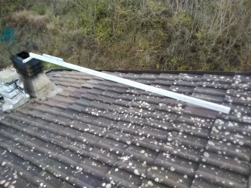

Hello everyone,
I would like an opinion about my chimney hat,
that is, after having found about 10 ppm monoxide I am analyzing everything
my doubt,
I think I should add some concrete elements to give more space for the smoke to come out,
or shorten the steel flue pipe,
could this be the cause of a slight presence of monoxide?

thanks, in my case monoxide comes out during normal operation, i made sure that it is not something that heats up near the stove, i removed the concrete cover, above the chimney and my monoxide detector says 0 but i am thinking of another further problem, the chimney is lower than the top of the roof, it is the one on the left in the photo so, i wonder how much and how i should extend it

We have the 2-3-10 rule.
A chimney must project at least 3 feet above the roof on its shortest side and also be at least 2 feet above any roof structure that is within a 10 foot radius of the chimney.
I would for sure get it above the ridge line; wind can curl down over the ridge pushing exhaust back into the chimney.

the metal rod is ten feet (3 meters)
and the flue should rise at least 2 feet
or more.
I wonder if adding a piece of pipe,
2-3 feet, without a cap, is a valid test,
or without a cap could I still have cold air descending in the flue?

Cold air can always descend in the flue regardless of the cap.
But if you see CO during normal operation (when the flue is warm) it's more likely that it is wind curling over the roof ridge I think. Adding height will help then. It's fine to test with a cheaper single wall stove pipe extension on top, but this should be replaced with proper chimney later on

after adding 30-40 centimeters of pipe something happened, if you see my first photo, after 3-4 inches, in the flue pipe, started a light and thin layer of creosote, well now with temperatures just enough, at the first fire that creosote has disintegrated, this makes me think that indeed, I had cold air in the flue that went down even during operation hope this can help others
