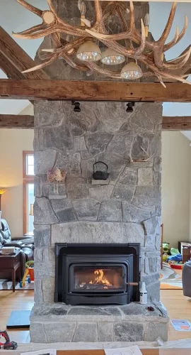

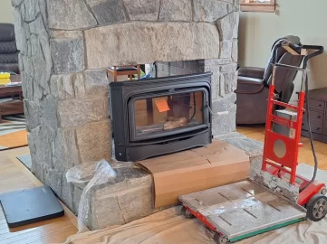

We have a double sided fireplace and installed a BK Princess insert on one side. Our setup is not in the center of the room like yours -- we have one side in the family room and the other side in our dining area.
I thought I would want to brick up the back side (dining area), but we get some heat off the back that helps warm up the dining area. Our fireplace had doors on both side -- I left the doors on the back side, but open it up when we're burning to allow more heat into the dining room.
Since your setup is all in one room and does not appear to have doors, you might consider something like a fireplace screen on the back side to allow heat to come into the room while still blocking the visual of the back of the stove. I feel like this would be an inexpensive thing to try while you decide if you want to block it off completely etc. I don't know what the code is regarding an exposed rear of stove is -- it may need to be covered by more than a fireplace screen, in which case maybe a piece of perforated or decorative metal sheeting that is screwed into the brick might work.
I would probably not store wood back there unless is it securely blocked with cement board/brick, etc.
We love our BK! I think an Ashford would look great in your space. Here are pictures of our setup:
[Hearth.com] Is running two back-to-back wood inserts crazy/dangerous?
