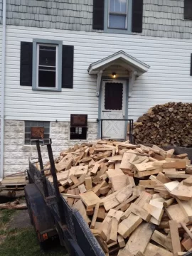

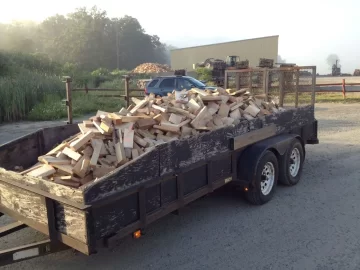

Due to unforeseen circumstance (an imminent career move which is taking up most of my free time) my wood gathering just is not happening the way I had hoped it would this summer. I've had time to get in some kiln dried oak ends from a local hardwoods manufacturer and could easily get enough for the entire winter (see photos). They fill my 16'x6' trailer with 2' sides (1.5 cords) for $50. Four of those loads is about six cords and I'm putting it in my basement (using the coal chute) and garage in bins I've constructed for that purpose.
The kiln dried stuff has moisture content well below 10% but doesn't last through the night. It's too small. It's fine during the day. We just have to load up the Fireview more often.
I do have a lot of ash, cherry and maple still needing CSS for the coming season. (I'm just setting aside the oak for now.) But by the time I get around to it, it will not be adequately seasoned for the coming winter. I also have approximately half a cord of CSS ash from last year (on the right in the second photo below) ready to burn this coming season.

Fortunately they use a large front end loader. You pay $25 per front end loader bucket full. Two scoops from that front end loader ($50) almost fills up my trailer. And the good ole boy running the loader always throws some more on to make the trailer FULL. It's about 60 miles away but for the quality of the wood, kiln dried, it's worth the trip to me. I put a link in my original post to their website in case anyone else is close enough to take advantage of it.
great find, but wheres the fun in buying it that way....you're missing all the fun of cutting and splitting......yeah right, wish i had a mill close by. think i'd bring the front end loader operator a six-pack, pie or something as a little token of the "extra" consideration of rounding out the load.
