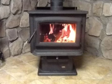

"I have a 930sq ft house - is the PE vista a good option for me in terms of having a enough heat? The main part of the house is open, with a narrow hallway down to the bedrooms. I've had enough of my ancient Kozi, live in a small Canadian arctic town (Inuvik, just south of the treelike) and a dealer is offering decent prices on the PE vs. the equivalent Blaze Queen (or whatever its called).
Any thoughts?"

As to the first response here are some points to consider: The house is a stick built bungalow built in the 1970s. It, like all of the houses here in Inuvik, is built on ~4ft high blocking (some are on pilings) to allow air to pass under so the permafrost doesn't melt. This means there is no basement. The house I think is pretty well insulated. It has r20 walls plus 2 inch foam board, taped, all around with new siding, it has new triple pane argon filled windows, the ceiling is r40 and the floor is r40 with 1.5inch spray foam all under the house. The stove would be expected to work on par with the current 2 year old gas furnace as the main heat sources. If it worked well I would burn more. The coldest we'll get is -50`C but the average winter temperature for November-March is probably -30`C to -40`C. It's cold The old stove has a bit bigger dimensions than the PE Vista but I don't know exactly. It heated the house fine - the stove is right in the main room which means it heats the living, dining and kitchen pretty good. The bedrooms at the end of the hall can get chilly but I'm getting a blower switch installed on my furnace which should take care of that. The only problem with the old stove is that it burns way too fast and could make the house too hot. It's pretty old I think.
As to the second post: I'm nervous about getting something too big right off the hop because I don't want to be sweating while I watch TV or eat dinner. Also have to consider size in my available space. The Vista will be just smaller than what I have so far so I know it won't be a problem.
Let me know everyone!
