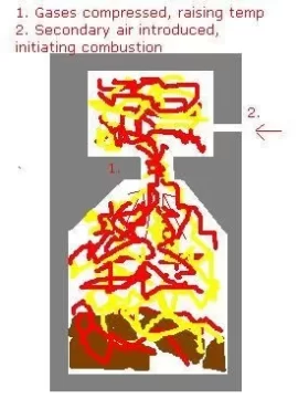

There's another, possibly easier method you could do for secondary combustion. Rather than relying on the coals to provide the necessary heat, you can make a baffle box at the top of the stove, since your stove is (I think) cylindrical. This method is used in masonry heaters. At the top of the box, you fit three plates so the gases have to make 2 180 degree turns, after being compressed by the wedge shape and the secondary air introduced.
  • [Hearth.com] IR Thermometer 'Snapshot' - Hot Coal Bed...
Sounds like a great idea Peter!!

Thanks for that drawing. It looks like I could do something like that to my johnsons energy system fairly easily!
Thanks Billy

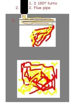

side view:
note the three plates in the secondary chamber

Cowboy Billy:
I wish I could draw worth a dam so I could post something that might better explain what I've done... but I can't... and the photos I've taken so far (frankly) aren't that great either. Sorry. Maybe I'll try again for some decent pics, but...

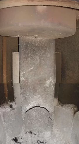

Edit:
Here's a (bad) composite shot of the lower baffle entry. The 3/16" box steel has (over twenty years) been 'burned' to the arch in the center of the pic. It does get hot there. To the left is the (very primitive, and undersized) secondary supply I'm currently using.
