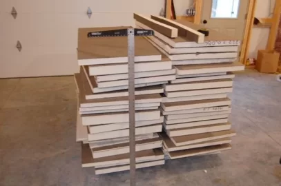

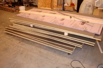

I started the final insulation of my tank area today. I pick up some foam board from a nearby manufacturer. It is the same as the foil faced foam but it has a fiberglass paper on it for fire protection. It is R6 per inch. They sell seconds and I got some 4X8 sheets that are 1.2" thick for $3.84 a sheet. I also got a 4'X4' cube of random pieces for free.(see pics)
I put down 1" pink foam for moisture resistance on the concrete and now I am layering in the other stuff. First layer is 2" thick pieces. I think I will put in 6" so I can still wrap the tank with fiberglass.

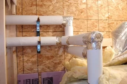

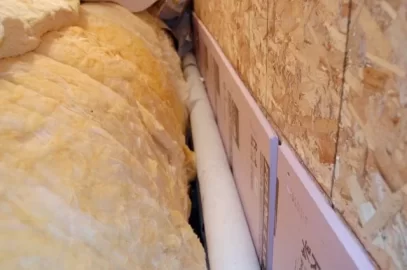

Also all my Copper pipe has 1-1/2" fiberglass pipe insulation. (see pics)

What a pain! I spent most of the day cutting random pieces and getting them under the tank with limited space.
Under tank I have 1" of pink and 7" of the Polyisocyranate commerical roofing foam board. I also have R19 fiberglass between tank and foam.
