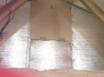

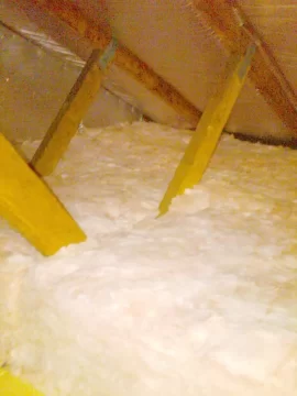

Don't forget about the Foil to keep your house really cool in the summer!!
The Reflectix foil at Home Depot will keep your house 10 degrees cooler in the summer!!
No kidding my attic was 115 degrees the other day in the late afternoon and my neighbors was 125 Degrees!!
See pics below

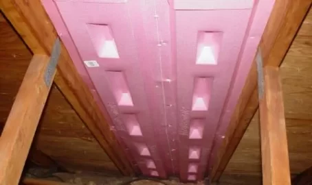

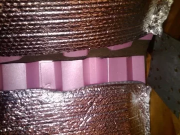

1. Add Pink proper vents in attic ceiling from soffit vents to ridge vents
2. Staple foil over the pink vents

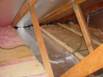

3. Add 2x2s added to the 2x4s in the attic floor
4. Roll down the foil
5. Roll down faced Pink Fiberglass R19 6" thick to fit in newly created 2x6s
6. Crisscross with unfaced fiberglass R30 9" thick
Total R53
Foil in Ceiling
Reflects heat back in winter to keep house warmer
Foil in Roof
Reflects heat out in summer to keep house cooler
Really works!!

Uh, those vents are supposed to just go at the bottom and just a bit over the top of the insulation. You don't run it from soffit to ridge!

Hello Nate
By running the vents from soffit to ridge like they do in a cathedral ceiling, it keeps the cold soffit air separate from the warm attic air to keep the house much warmer in the winter. If the air was not separate, the cold soffit air will suck out the heat in your house like a hover vacuum cleaner!! Try it, it really works!!

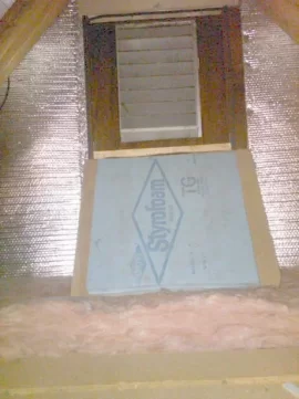

Also, I made insulated doors for the gable vents so I can close them up in the winter. Another way to loose large amounts of heat!! It is a difference you can feel downstairs and all the way to the bank!!!
See pics below:

Taking the Styrofoam vent channels all the way to the ridge vent doesn't seem right. How does the moisture get to the ridge vent? Seems like it would be the same as putting in a pipe line from soffit to ridge
Hello
There is still a space at the peak so any moisture can escape. The bathroom fan is vented outside like it should be.
The cool air from the soffit to ridge under the styrofoam works well to keep the roof cool and no ice dams.
The air inside the attic in the winter now with the gable vent doors closed is warmer than the outside and keeps the house warmer!
No cold breezes coming in to suck out the heat anymore!!! YAY
  • [Hearth.com] Insulating attic
How about the summer temps up there? I bet it's ROASTING! My attic will get close to 100* when the sun is beating down.
