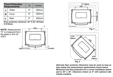

The 40" pad won't be big enough for clearances for that stove. I'm pretty sure about that. You need 9.75 inches from the corners to the back walls if I remember correctly unless your walls are non combustible or you install heat shields on the walls. You still have to maintain 6" from the glass in the front too.
Looks like all he needs is 6.25" to the pad corners. The pad doesn't need to go all the way to the walls. Minimum in the manual is 36" sq. for a corner install.
That's a minimum square under the stove. You need quite a large pad to get that when the pad is turned. Thanks for the illustrations
Also shows the minimum 36" pad in a corner with wall side shields. Without shields and maintaining all clearances the pads ends up being something like 46.25" and a 48" pad is the closest largest standard size.

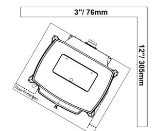

Stove clearance requirements are often independent of the hearth pad protection requirements. The pad doesn't need to go to the corners. Can't you just rotate the pad so that it is parallel to the stove sides and sit it in the corner, honoring the stove clearance requirements? You can pull the stove as far away from the walls as required.
I've seen a few done this way. It doesn't look too bad.
