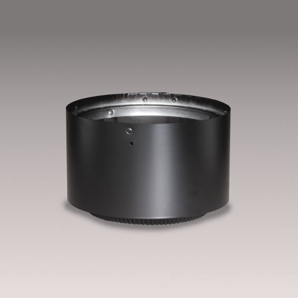

The fit from stove collar to flue is started with a 'stove to double wall stovepipe adaptor'. This piece does not have (what I consider) a proper fit to the collar. As I am familiar with, the male/female fit is tight, compressed and sorta forced fit and then screwed with small sheet metal screws. The fit provided here is slop, maybe 1/4" gap. The male end is considerably small for the collar opening. And also, this fit bottoms out on 4 tabs around the base of the collar. So the fit is not flush wih top of collar (about 3/4" gap from stovetop or collar to adaptor).
It don't seem right. Especially if one considers the $$ invested. I expect a smooth transition stove to ceiling and beyond. I've been told to use stove cement to fill the gap and trim the male end around the tabs for the final fit. Huh ? Is this how far this industry has come (from my last Buck 28000 slam and jam installation) ?
Does the DVL stovepipe fit into the stove collar without the adapter? Stove cement will just crack and fall out. If the adapter is a necessity, the crimping can sometimes be smoothed out to make the fit tighter. Fill the gap with stove door gasket material or if only 1/8" with flat stove gasket like what is used on stove door glass.
Thanks for your knowledge and reply. I have not yet taken the telescoping piece out but I will now and get back. I have tried the adaptor without the collar, and it is a hair too large to fit inside of this opening. This would be stove top without the collar. I'll see about this fluepipe fit.
I noticed below this thread where other 'related threads' are listed and the first one is a very similar sounding situation except a rear flue instead of top, and Selkirk instead of Duravent.
hmm, that may work. None of the holes line up, and the collar is off the stove (so I'm not sure about the finish fit and look) but the flue fits into the collar nice and tightly.

Our stove didn't need the DVL adapter, but I did have to drill new holes to tap into the stovepipe.
Reactions: EbS-P
yes, that is the part shown by EbS-P. All $55 worth. I think that direct attachment to collar from telescoping 6" doulble wall flue will be a 'professional install'.

There are two adapter options to transition from the DVL to the chimney support box. The 6DVL-ADC is an improved version of the original stainless sleeve adapter. The 6DVL-ADT is a stouter version which I like better. It affords a more solid joint and screw connection. Both will get the job done.
yes, and the fluepipe is such a tight fit, I'll have to make cuts (probably 4) to get it to tap down on the collar and meet the stove top.
I recrimped it with a crimping tool a couple of times and that worked well for a snug fit.
