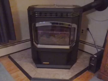

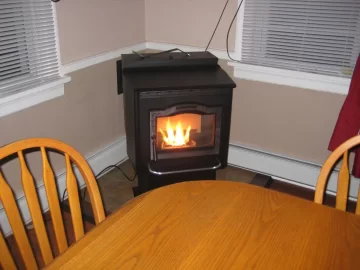

I'm planning on installing a Harman P43, in the corner of my living room. The corner I want to use has baseboard heat on both walls.
Would this be very problematic?

Would think it would be fine as long as you maintain all required clearances....baseboard not really considered combustible I would image...and nothing from stove would impact its operation if needed, except maybe restricting some air flow around the baseboard.

I intend on buying a corner hearthboard, and framing the bottom in with 2 x 6's to bump it above the baseboard. I would be 5 - 6 inches above the baseboard metal, (the piping is much lower).
That would certainly have been a problem. I figure the height would be nice for heat distribution and ambiance.

Nice setup! I actually have a window in the same position too. I'm pretty sure the manufacturer recommended height of the center of the exhaust is 10" on mine. So I will be raising my hearth with 2 x 6's.

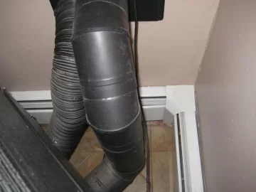

My baseboard are 7 inches, do it was a close git to the 10 inches on center for my p42. But with two inches from the heart pad, and a set of tin snips, I was able to make the piping fit by simply taking half an inch off my thimble.

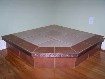

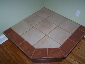

Easy and fun!! just build the frame out of 2x6, topped with 3/4" plywood and 1/2" cement board and you will be all set. I did mine with a little overhang also. Here is a couple of pics.
