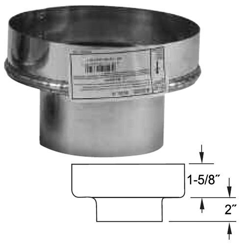

Now this would seem common, but I havent found any good descriptions of anyone that has vented into plain 6" stovepipe. Is this possible? I see many 3 or 4 inch to 6" chimney adapters like...
^that one from Selkirk but it looks like something that is meant to plug into a masonry thimble, not stovepipe, or am I wrong?

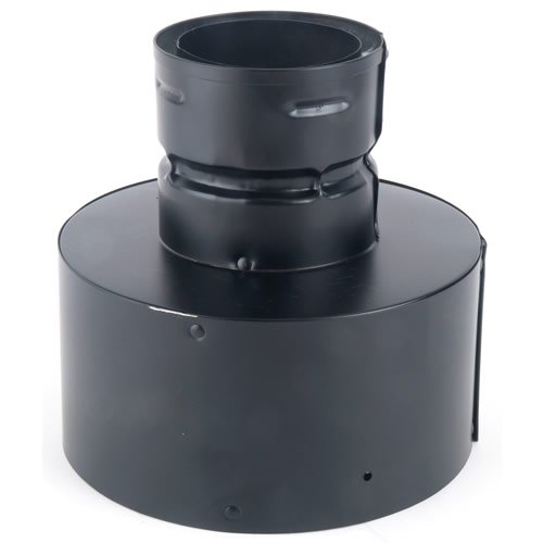

Also adapter commonly available from DuraVent...
http://www.amazon.com/Pellet-Stove-..._sim_hi_9?ie=UTF8&refRID=17CKQJRM469X1YMZF2TR
That one is suppose to hook up to class A chimney. I've never seen class A chimney but I get that its not single wall stovepipe.

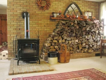

For reference, here is the stove I'm replacing:
Basically I'd like to put the adapter on the pipe that comes through the thimble - have a shorter piece so I think I could butt the adapter flush against the thimble cover, then a 90 elbow, 36" 3" pipe + an adjustable length piece, then another 90 elbow and appliance collar. Will this work?
![Install pellet burner in place of existing woodstove? Install pellet burner in place of existing woodstove?](/talk/proxy.php?image=http%3A%2F%2Fecx.images-amazon.com%2Fimages%2FI%2F418QGKBMScL.jpg&hash=b872d25df23f01c87c97b080b0b6133b)
![Install pellet burner in place of existing woodstove? Install pellet burner in place of existing woodstove?](/talk/proxy.php?image=http%3A%2F%2Fecx.images-amazon.com%2Fimages%2FI%2F41i5ehPtK2L.jpg&hash=b9deabf312a574472ca7a15a8ba6f448)
![Install pellet burner in place of existing woodstove? Install pellet burner in place of existing woodstove?](https://www.hearth.com/talk/data/attachments/139/139183-d99d67e9b4835b41c020d8175a8b9089.jpg)
