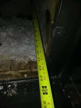

In looking for an EPA insert, Osburn says the box is only 14 or 15" deep........are you sure that it will take a 20" log NS??have the Osburn 2400 insert. 3.2 cf firebox. It's a heating beast. EW it takes I think 22" and NS I'm positive it takes 20" logs. So I'm not saying it's definitely the insert for your dad, but it does seem to fit the bill. Protrudes about 7-8" into the room, and uses 6" liner. A lot of inserts look a lot nicer, but this unit is a heating beast. Hope that helps. Good luck.

Positive. It's 21" brick to glass.
