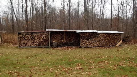

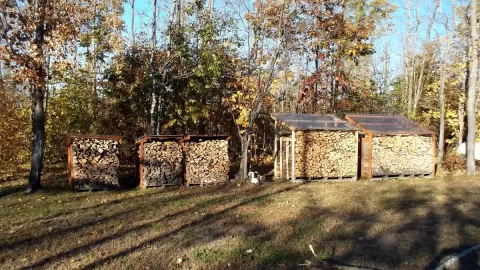

View attachment 160825 View attachment 160826
That right there is an impressive supply for a fire place burner - hope you get a stove soon
Reactions: STIHLY DAN
Thank you, it's been a lot of hard fun work... Keeps me out of trouble
