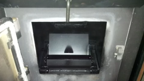

When he cleaned my heat exchanger and baffle, he used a wire wheel on a cordless drill. Works better than the brush I was using.
He was able to take the combustion blower off without destroying the gasket. He brought me the new reusable gasket. I asked him to leave it as I'll probably destroy the gasket when I do it.

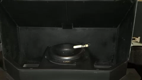

He painted the inside and said that's the best way he's found to take care of rust (as opposed to the PAM method)
He also showed me that for hard to reach or for those tiny crevases he had a small automotive vaccum hose with a rubber stopper on the end which made it fit on the shop vac.
The stove looks like the day I bought it.......Now I can do my own next year....
