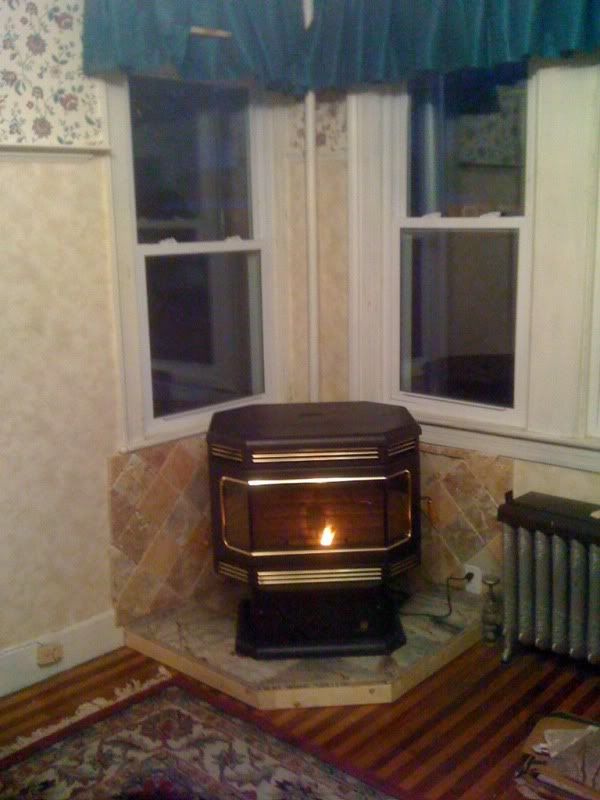

Kiver said:
I still have some touching up to do on the hearth, but it is going to rain the next couple days and I cut the marble outside. I also have to stain and poly some oak trim I got for the bottom

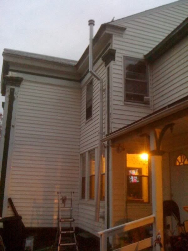

smoke show said:
Curious as to what your EVL equals?
And if the vent is 4".
4" pipe at just over 20 feet. Excellent air flow
I'm curious, would it be possible for him to attach the leaf blower vac to the bottom of that outside T? That long length of outside pipe may cool easily and allow for a lot of soot to accumulate on the inside of the pipe. Just thinking if he hooked the leaf blower vac up after every ton, he might not have to go up on the roof but once a year. Other opinions???

Wait..I have to go on the roof to clean it. Cant I just sweep from the bottom. I don't do well with ladders since falling off a roof in 98

You don't have to go onto the roof.
Theres a number of ways to clean your vent.
Your evl has to be more than 20, not that it matters cause you used 4".
I'll get a more accurate EVL when I get home. I estimated 20 feet as from floor to ceiling is 8.5 feet
22 feet top to bottom
I used to clean the metal bestos chimney to my wood stove from the bottom by pushing a brush up and just kept adding on extensions. But I didn't have any bends in my chimney. Not sure if a there is a flexible system to push up through those bends.
I would go back to whoever installed this system and ask them how this installation should be kept clean.
In the meantime, go to youtube and look up leaf blower vac cleaning a pellet stove.
Wow Excellent install inside and out!! The install crew really knew what they were doing!!
Congrats and good Luck
