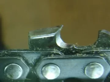

After one trunk i figured out why they'd been left alone. Someone had put a nail in the middle of the trunk, hidden 3" into the trunk, and impossible to see prior to cutting. It was larger than a 16 penny, possibly as much as 3/16" in diameter. I didn't even notice it until I went to cut the next limb and struggled to cut a 3" piece... Then I looked back at the round I'd just cut and knew why that bastard had been such trouble.
My question is, should I even try sharpening the chain? Looking at the teeth, some of them have 1/16" chips missing... should I hold off and take it to my local Stihl dealer and have it checked? Is there a point at which such a chain becomes dangerous, or is the worst thing that happens is there is nothing left of the teeth to sharpen?
I would need a close up pic to see the damage but your local dealer should be able to tell you!
If you have a good camera need a very good close-up
You went through a 3/16" diameter piece of steel and didn't notice until the next piece? Must've been some pretty good chain, normally I know it right away when I've hit something...
Good chance to get the process of sharpening by hand with a good rig that will give you the right angles.
1/16" is a lot of loss but if the chain is new with enough tooth remaining you'll be fine.

If it was a fairly new chain, it can be saved, although it won't be fairly new anymore! If it's over half worn out, it might not be worth the effort, there won't be much left of the cutters after it was fixed. The chain won't become dangerous when the cutters have been sharpened to the point of nothing left. I routinely use my chains until the cutters are so thin that one breaks off. Then it's time for a new chain.

I'd very carefully inspect the chain for cracked straps or damaged rivets. Even if the nail was mild steel, the chain took a serious hit. If it fails that test, likely the chain is scrap- too dangerous to use IMHO.
We've saved many chains from this but it does depend upon the state of the chain when it happened and also how old that nail was. Sometimes they are so weak they hardly affect the chain but evidently yours did.
Follow Jay's advice and post a picture.
