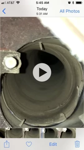

Here’s the inside of the liner. I don’t have a before and after but I’m a little concerned about the bottom right section in the pic. It seems a little buckled....

In the shot up the flue collar it looks like the install was done with self-tapping screws, two of which appear to be under the liner and not through it. It looks like the liner needed to go down in the flue collar another half inch or the screws need to be 1/2" higher. The righthand side pucker appears to be from the screw penetrating the liner. That looks to be easy to straighten with a couple taps.

I don't see anything in that picture that would overly concern me. Everyone, even on here, who burns wood has or will eventually overfire the stove. At least once.
