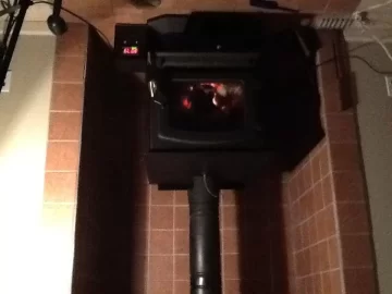

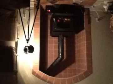

Here's the pics.

What is the main concern here? Room too warm or clearances? I too am a little concerned about clearances. The Baltic has no alcove installation specs. What are your side clearances? The stove does list an 84" ceiling clearance minimum. Does the alcove meet this spec?
I'm concerned about all the above questions. I think I may have one thing figured out. It's very cold outside and my heat pump is running . When it's running the heat in basement get locked and won't move upstairs. I do have a fan running blowing cool air down. This works quite well as long as the air handler is not running.
I think I will take out the arch and get the 84" that is required. The walls are concrete so no clearance issue there.The first 31/2" inches on the walls is tile over Sheetrock so just to be safe I"ll use metal studs with duarock or something similar. Does this sound like a good plan?
If you want to be by the book then yes, that is a good plan. Without the arch you will also get a bit more heat into the room. Shame though, you did a nice job. I'm starting to recall this install now. What was your handle before the forum software change?

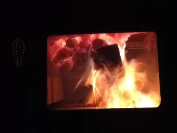

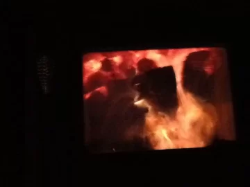

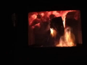

Here's a couple of pics. Justin case someone is interested.
[Hearth.com] I need help (maybe mentally after this) [Hearth.com] I need help (maybe mentally after this) [Hearth.com] I need help (maybe mentally after this)
Looks like there's a Balrog in there! :-)
