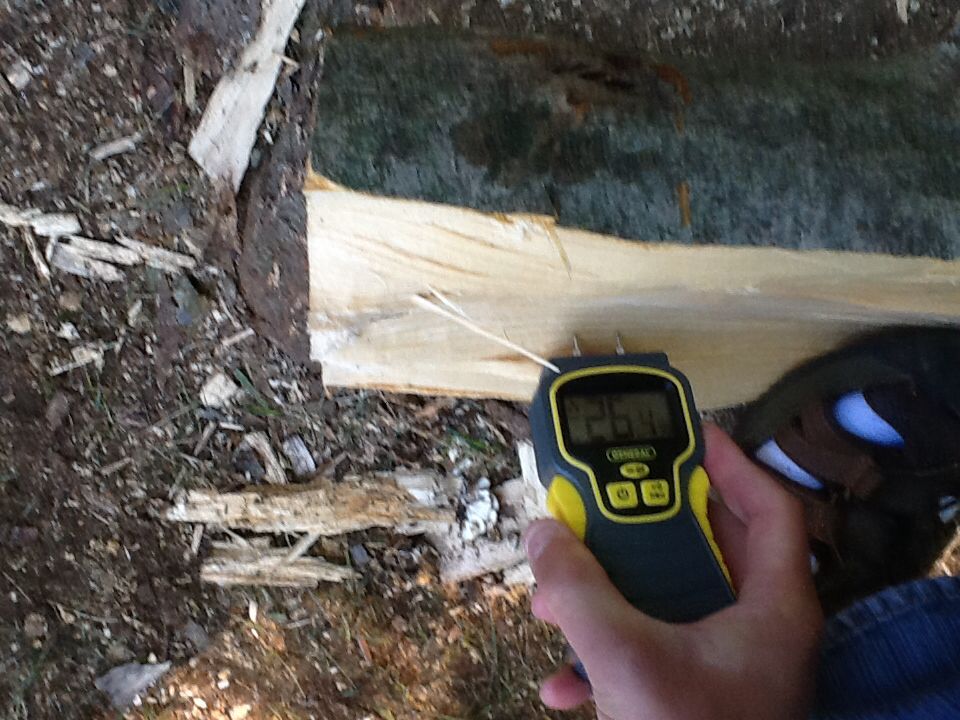

UPDATE...

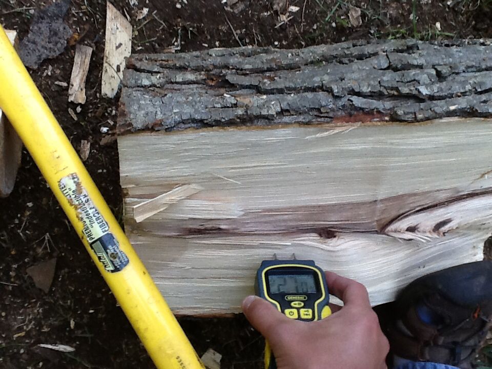

So I just went out and tested the freshly cut stuff again. I was getting the same numbers, around 25% until I put more pressure on the meter and stuck the probes in a little deeper. The MC went up. On the fresh Oak, I'm now getting 31% and on the fresh Beech, I'm now getting 28-29%. I guess now I need to check all my other wood supply again with this new method of adding more pressure to the unit. I hope those numbers don't go up too.![]()
Sorry, but either your technique or your meter are not correct. Freshly cut oak has way more than that. Any chance you can borrow another one from a friend?
