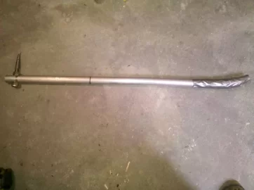

Every time I am unloading and processing wood, I think , man !! I wish I had a hookaroon, I looked at buying one but, I saw some ideas in a thread on here a while back about making your own and figured I just may have everything I need out in the shop, and sure enough I did.
Some 1" OD aluminum tubing from another project where trying to bend that tubing didn't work out so great ,so that's why you will see a slight band in the and of the handle, which I think is a good thing to have, and it turned out to be 30 inches.

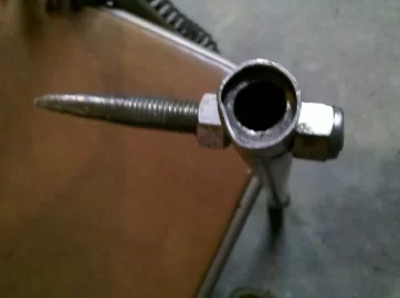

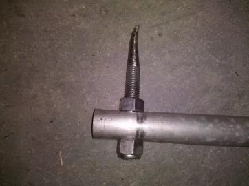

Then I got a piece of half-inch water pipe that just happen to slide right inside the aluminum , I made that peace 17 inches long.
I just happen to have some 1/2" , 8 inch long carriage bolts , so I drilled a 1/2" hole through both pipes at the same time , cut the head off the carriage bolt, ground it to shape , and put a lock nut on one side.

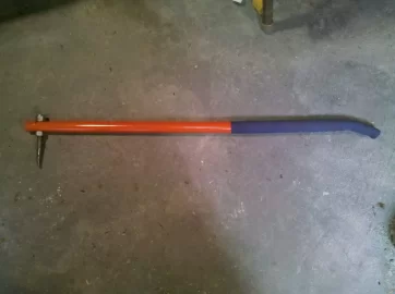

Tried it out real quick, works great
picked up some splits , stuck it in a 15" by 3 foot log and dragged it .
To put something on the end of the handle better than the tape, I'm thinking about using foam pipe insulation or bicycle handlebar wrap, or maybe both, any ideas on that ?
