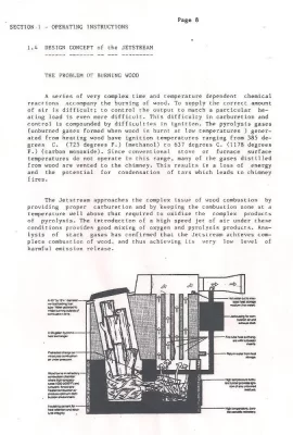

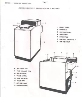

The vertical loading tube and burn chamber total 42 " in length and 12" in diam , small . Sending your wife out in the winter 5 to 8 times a day = divorce.
With adequate storage 1,000 gallons minimum it is efficient 75% to 85% range.
The cost of a rebuild could be expensive, so for not a lot of money more you could have a entry level boiler such as an Eco or Bio Mass .http://www.newhorizonstore.com/Category/54-gasification-boilers.aspx

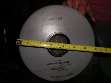

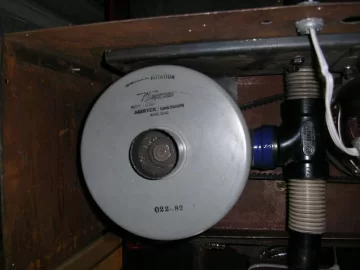

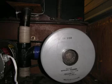

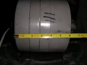

The Jetstream is a pressurized firebox and draft at 99 cfm at 85 inches water lift so it will force a fine pumice type dust through joints in the fire tube cover and smoke pipe and although not noticeable to the naked eye, it raises hell with the blower motor and blower.
I have attached a picture of the blower. The bearing can be obtained at any automotive shop, but the fan blades are obsolete. The new blades are metric and just slightly smaller and do not produce the needed pressure or volume. The only way to determine if the blower is serviceable would be to dissasemble and inspect the 3 blades. If the belt driven blower is not serviceable there is a vacuum motor cleaner option, but my feelings on this is that it represents a very large learning curve for somebody who does not know the boiler. The electric motor is also expensive at $200 plus.
The other possible problem is the heat exchanger corrosion.
My feelings on this Jetstream would be to pass as it has been up for sale for over a year. It would be of some use for somebody who would want it for parts! As I suggested to Fi-Q looking at a new Eco or Bio Mass, it might be money better spent . http://www.newhorizonstore.com/Category/54-gasification-boilers.aspx
