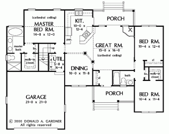

I'm in the planning stage of my new house, almost ready to break ground. The house is a one story with only 1500sf. I want to use wood as the primary heat. The house is fairly open design w/cathedral ceiling in the great room. It is designed for a fireplace, center of endwall in the gr. I was originally thinking of scrapping the fp for a regency s2400 in the corner vs center of the wall. That was based on mfg taunting low clearances, and I can keep it out of the way and use the center wall for TV. Need to save as much floor space as possible since the rooms are a bit on the small side. Then I read about someone installing a high efficiency fp, and started thinking I could still get the look and heat too. BTW, cost is a major consideration.
All this to ask, is there a place to help you choose the best fit?
My previous experience w/wood burners was an old kodiak insert.
Thanks - Rick
