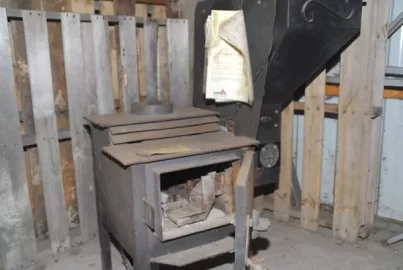

Early pellet stove wood stove adaption
  • Hybrids and multiple options????
