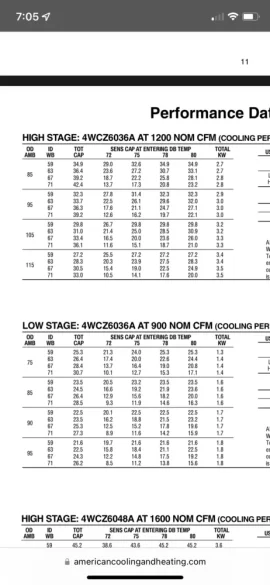

I'm an plumber/gasfitter who also does some HVAC work (in MN/WI so different climate) so I'll give my 2 cents here...
Your current unit is undersized as you know. Encapsulating your crawl space will help but won't change the fact that you have an undersized unit (maybe over or undersized ductwork). You may spend 10k encapsulating and that won't change your heating problem (it will probably help with the humidity though).
You need someone to come in and do a full manual J and then manual D off of that. Where I'm at most HVAC companies don't do those. They just use "rule of thumbs" or replace same to same (or next size up if there is heating or cooling problems). If you put in bigger unit with more CFM on the current ductwork than that creates a whole another set of problems.
If it were me, I would find a company to do a manual J and have them run it with options for crawl space as is and encapsulated/insulated. That may help you decide if it's worth it.
An online rescheck/manual J is one option if you can get them the proper info (he will need plans, info on windows, insulation, etc.). I used this one in the past: https://www.rescheck.info/2017/05/11/do-i-need-a-rescheck-manual-j-or-both/.
Alot of smaller 1 man shop HVAC companies use this to satisfy code requirements for permits when installing new systems because its so cost effective. I used it to properly size our cabin when converting from electric baseboard heat to forced air. For 79$, it won't be 100% perfect but will get you in the right direction.
Regarding the dehumidifiers, as others had mentioned they will heat up the space unless ducted outsized or to an area that can use the heat. A whole home dehumidifier will certainly help. They tend to not last very long so I would be hesitant to spend a ton of money on that. A properly sized cooling unit will dehumidify the space (but not the open crawl space.)
Lastly, if you have duct board in that crawl space, it probably needs to be replaced. We don't used duct board or much flex here because we have full basements but insulated flex would be a good option for you if you need to replace the ductwork. It's cost effective and when installed correctly works well (pulled tight, minimal turns, no sags, dips, etc.).

It’s does thank you. I was up front with my HVAC contractor that I want a full load calc. The reason being that I don’t think they have ever tied a HPHWH into the supply duct. Add the whole home dehumidifier and it’s adding 4-600 cfm of intermittent flow to the supply side. And that really needs accounted for in my opinion. Is this an easy entry in the manual D?
And I’m not really super concerned about the load calc. The old unit is comfortable 95% or more of the time and fixing duct leaks will get me more a decent bit of capacity back into the house. But it’s going to need replaced some day and have appropriately sized ducts for the correctly sized future unit I think is important.
Yes anything can be accounted for in the manual D but you can't do a manual d without a manual J first.
If your unit is comfortable 95% of the time, I don't think you need a manual D as long as the extra cfm is accounted for in the new ductwork. Installation of new ductwork and proper air sealing in your home will probably make up the difference. The installation makes all the difference in the world. Even with a proper load calc or manual d, it can all be messed up with a poor install. I'd try to find an installer that finds useful solutions to your issues that you trust and go from there. Implementing a perfect load calc or manual d in the real world is not always possible either.
Also, if you are pushing that much extra CFM into the supply, you will want to account for it in the return sizing also (you can never have too much return air and it's almost always grossly undersized).
Problem will be finding any HVAC contractor willing to do load calc or manual d (for sure not a manual D, they are almost never done is residential installs where I'm at). If everyone is as busy in your area as they are here, they will just move onto easier jobs if you ask for both of those.
Start by getting a Manual J and go from there. Duct sizing is relatively easy at that point when you have correct individual room loads and friction rate. And again, almost all existing ductwork is undersized, espcially when paired with newer units.
If you don't want to submit the info yourself to an online rescheck company, look at having an energy audit company or someone similar come and look. They usually have the skills and tools to do a proper load calc. I think this was mentioned by someone else also.
