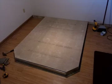

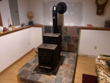

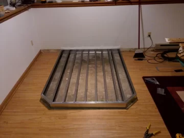

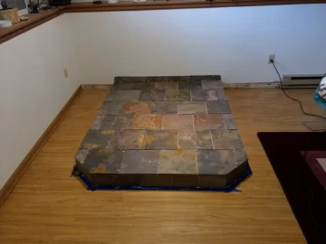

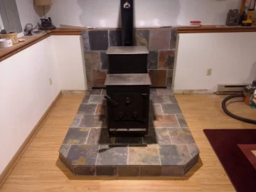

I bought this stove in the early 90's, it was used...finally got around to installing it.
I had lurked around this site for awhile then joined a few weeks ago, got a few ideas and a lot of good info from here.
I have a Raised ranch about 1200 sq ft, and this is installed in the basement rec room.
I used Selkirk 6 inch SS double walled pipe for the chimney.
I did a raised hearth on concrete floor, with steel studs approx. 6 inches OC and 3 layers of 1/2 inch hardie board, then slate tiles.
The heat shield is one layer of 1/2 inch hardie board with 2 inch metal spacers.
I'll finish the drywall then paint and install the baseboard this weekend.
But I got far enough for my final inspection, so I had the building inspector here this evening.
He passed everything...then I called my insurance company gave them all the info and I'm good to go.
