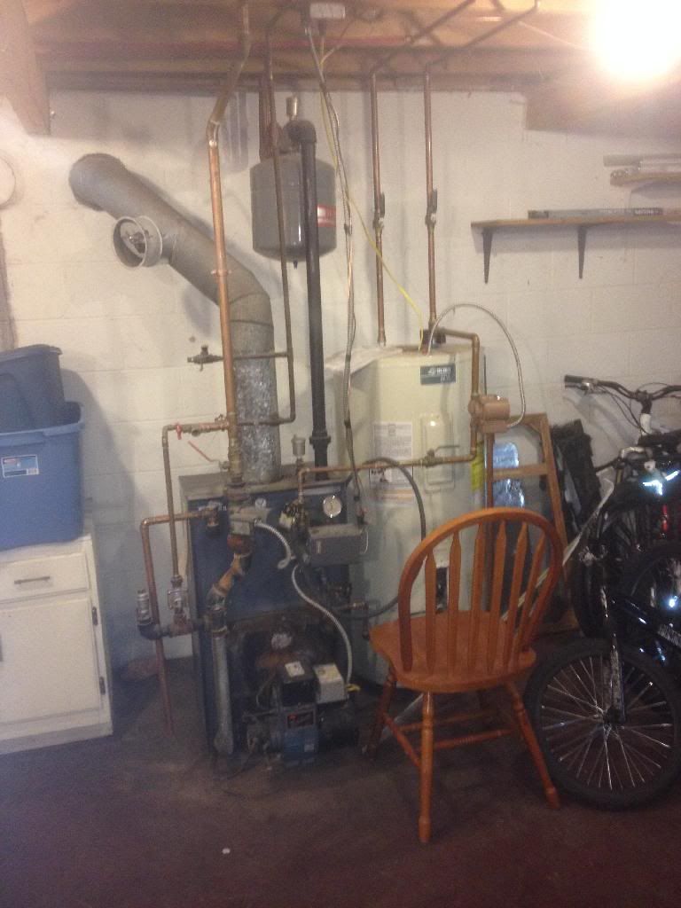

Hi from frost cold VT. I've decided to go for a pellet boiler, but am sort of lost on how I can install this myself. Was quoted 10k to 15k for a pellergy, kedel or similar installed. Am looking at doing a Harmon stove with conversion kit, or if less expensive, a LMF Americas heat, if I can find one. What I'd like to do is connect it in series to My Weil McLean, to use its plumbing valves pumps, etc. I just don't see how I do that, or what I need to buy in addition to the boiler itself.

I guess what I need is a pellet boiler integration/installation for dummies. Any help and guidance would be appreciated.
I would recommend looking at a pellet stove, getting familiar with it, and then making a decision based upon some user experience. A boiler is a big expense, no one wants to make a mistake.
Also, if you want to learn about how a system is piped, and if you were looking at the Harmans, just download their manuals, I'm sure they show basic serial and parallel plumbed setups.

I second what chken just said. "No one wants to make a mistake." Now that winter is winding down there's no need to rush out and buy something new on an impulse. You should take at least two or three months to research any and every product that you might be interested in, see demos on all of them, do internet research, talk to people who already own them, talk to plumbing heating guys, look into state/federal rebates and financial assistance etc etc etc
You'll enjoy being in your nice warm home next year with whatever solution you choose providing that warmth knowing that you have no regrets about the decisions you've made.
