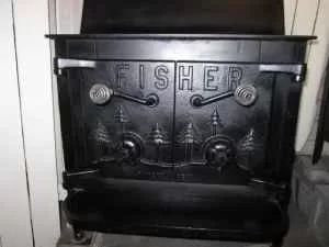

Can anyone tell me if these stoves are still legal to use? I had a chimeny cleaner come out and when they saw my papa bear stove, they refused to clean it and left.
First, there are many models of a Papa Bear. UL Listed and Unlisted. (no UL tag)
Different jurisdictions adopt codes sometimes requiring only UL listed appliances to be used. State laws vary and local ordinances can be stricter than state wide, so it's best to check with your local ordinance / codes. Most allow them to be used when connected so they are Grandfathered until removed. They can usually stop you from a new installation since any permit requires the appliance to be UL Listed. Many insurance companies require all appliances to be Listed as well.
WA. OR. and CA. only allow EPA Certified stoves due to smoke regulations and those states do not grandfather installations or allow property to be sold with the non-certified appliance.
Did they give you a reason for not cleaning it other than the stove make and model? They should have at least quoted the code if it is a local code violation.
Clearances, pipe or chimney condition? I'd call others and let them know what you have to compare their response.

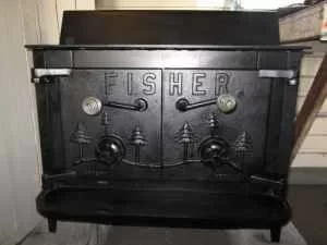

The star things were patented by Bob Fisher's dad and called them " air dampers", also known as air intakes or "draft caps".
Read the manual for Fireplace Series III in the Sticky Section at top of Fisher Forum page.
There is certainly nothing wrong with using that stove. Bob Fisher had no problem putting his name on over 1.5 million of them !![]()
I noticed that you said to close the damper that is in the vent pipe, I noticed last night while looking good at it that there is not a damper on the vent pipe to close or open to adjust how much heat goes out the chimeny pipe.... are the star knob bs which turn to open be considerEd the same thing? With doors closed I would not be able to see when the smoke starts to roll back in though.Grandma III as shown on manual front I posted.
