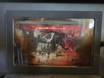

I finally had days off again so I got a good picture of what the flames look like when its cruising low. Most of the flames are above the wood or coming from the secondary burner. Nice and pretty to watch!
