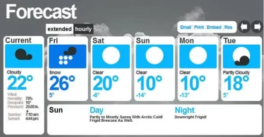

See Low Temps Forecast for Salem NH (small numbers) for 01-20-2011 !!!
